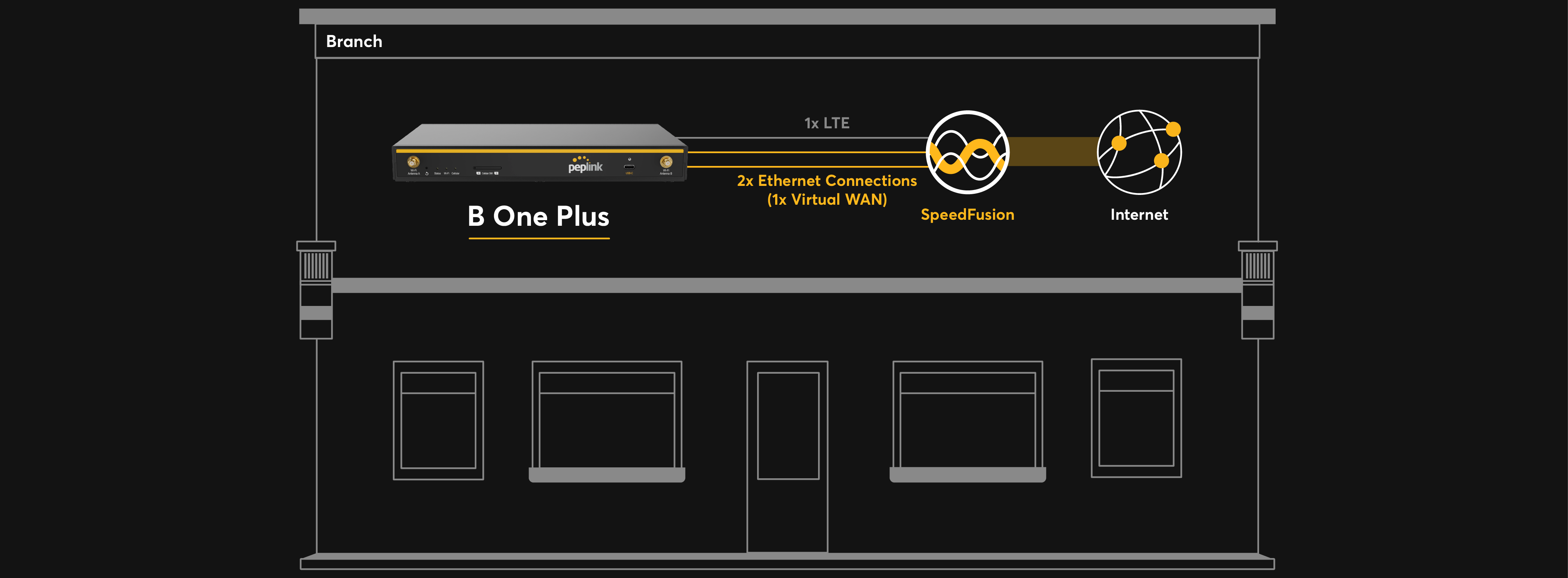

Scenario 1: B One Plus
VWAN Scenario 1
The B One Plus is a PrimeCare model, which means it enables 1 Virtual WAN support by default, so it's easy to obtain 2 wired ethernet connections to work alongside the built-in LTE. In addition, it can support up to 3 Virtual WANs over VLAN for quick and easy deployment.

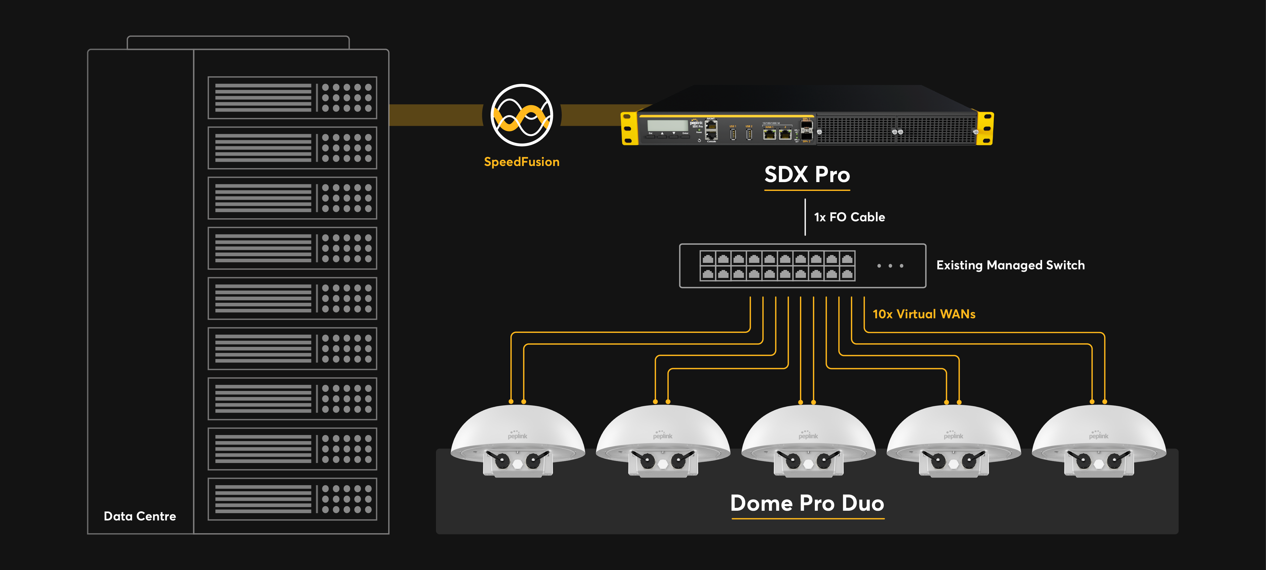

Scenario 2: SDX Pro
VWAN Scenario 2
Enable up to 10* Virtual WANs over VLAN for your SDX Pro, eliminating the need for physical connections from the Dome Pro Duos, especially if you have existing infrastructure. Simply connect the Dome Pro Duos to your existing managed switch, and run 1 fiber optic cable to the SDX Pro, providing 10 LTE connections in 1 cable!
*10/25/40x Virtual WAN is not enabled by default. An additional license is required for activation. For more details, please reach out to your local certified partner.
